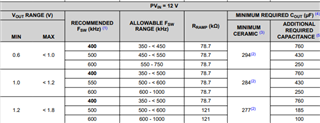

  • Hi K. Hirano,
    I investigated the schematic you used on Webench further, and it appears that the SW node voltage is irregular given the schematic you simulated. At lower duty cycles, advanced current mode control models are difficult to implement, so I may need to explore a further effort with the modeling team to correct the model based on physical data taken using the part.
    Based on a 290nH inductor selection, the following table can provide you a ramp selection and output capacitance range at which the device will have stable operation (please note that the capacitance values are effective capacitance values and the design should account for derating when using these values):
    Please reach out regarding any help in designing with the TPS54C20A.
