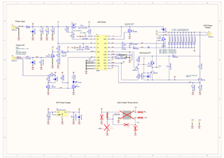

    Thank you! The IS current detection implemented with a 50mOhm resistor. As a result, the IC did not die! Originally, I wanted to take advantage of the Rdson sensing as I saw in the datasheet, but this is a more precise, better solution. I have attached the current state of the circuit:
    But my LED's are still not lit. Slight smile

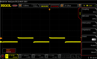

    I can see this pwm signal on the DDRV pin when I connect my fucntion generator to PWM_IN, so I assume the "left side" of the circuit is working fine:
    The amplitude is about 6.8V, same as votlage in VCC pin. But between Q6 and Q5 (TP7) I can only see a verry small change in the voltage. It is not enough to operate Q5 mosfet:
    This "buck-bust dimming circuit" is not so simply. But I see no difference between my version and the AN-2010's circiut.

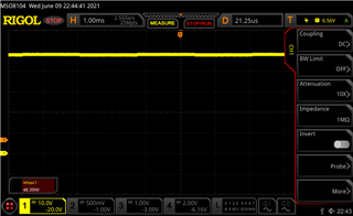

    No, it is not boosting at all.
    VIN, EN pin: 48V.
    FLT and TMR pins: 0V, so there are no fault condition AFAIK.
    VCC pin: 7.5V, so internal supply is OK
    LED+: 48V constant
    GATE pin: 0V constant, no pulses, not a single one.
    In this condition, the pwm dimming signal from nDIM is transfered to DDRV.
    Also tried with hiher OVLO setting, but had no effect.
    Did you try shorting out Q1 as I mentioned previously to do the test?  Other than that you will have to trouble shoot your board as to why it's not working and whether it's the modification related to the IS resistor.  You need to monitor all the pins voltages to figure out why it's in shut down.
