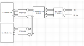

We are working on -48V, 2A load (typical) with -40V to -60V input range. TPS23523 is used to protect TPS16630 and load if input exceeds beyond the limits.
We have used the enable of TPS16630 to start the loads individually. At a time either or both loads can be enabled.
Please suggest :
1. Can we use TPS23523 with TPS16630 for negative input scenario?
2. Our load can take input upto -75V but because of small footprint of TPS16630 we have used TPS16630 and limited ourselves to -60V.
Can you please suggest any alternative to TPS16630 with small footprint?
