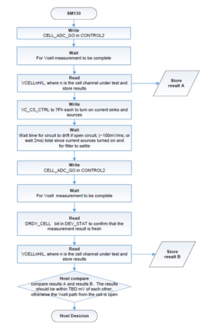

Do we have VC Wire Break Detection Procedure of BQ79606 like below diagram format? Customer is looking for it. Pls help us here. Thanks.

Hi Stanley,
The feedback I received is that this is the procedure for the BQ79606-Q1 device VC Wire Break Detection.
The procedure is described in this document: https://www.ti.com/lit/pdf/slua822 on page 27.
It this what you are looking for?
