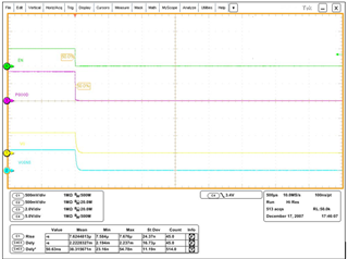

Hi Weidong-san,
Sorry, My customer wants you to take same capture which shows that behavior on EVM though, Can you check that on your bench and share the capture?
Takashi Onawa
Hi Onawa-san,
When EN goes low, PG will go low as well. Please see the below picture.
However, if VIN also goes low, then TPS51200 won't be able to pull PG low and PG will be floating. If PG is pulled to a different voltage which still stays high, then PG will go high in this kind of condition.
