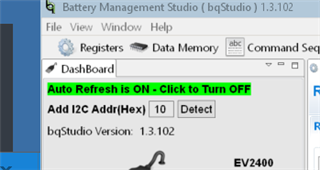

    I configure the BQ76952 by setting the i2c address in BQs to 10.
    However, I observe through an i2c  analyzer that a handful of commands still try and use AA as the address even though the rest of BQ is using 0x10 for the registers, data memory, etc.

    I believe this is something to do with the auto-detect logic in BQ. Is there a way  to turn that feature off and force BQ to only look at the bq76952?
  • Hi Richard,
    That is a good find, I did not recognize that you had another supported device on the bus.
    BQStudio has a Window>Preferences>All Global Settings>Alt I2C Device Address where you can enter alternate address, I don't know if you can turn off auto detect.
    You can turn off dashboard refresh which stops the auto refresh portion, not sure it will turn off device autodetect.  Click on the green banner in Dashboard to make it turn red.
  • Hi Richard,
    If you download the new "Test" version of BQStudio, 1.3.104, under Window>Preferences>All global settings you can disable Auto Detect at launch.  You might see if this solves the issue you encountered.
  • Hi -- I tried this option but it does not work properly. Even though auto detect is off, bqstudio still probes the device at address aa and tries to configure bq7652 at AA, reading the wrong registers into the UI.
  • Hi Richard,
    Thanks for letting us know, I will pass this on to the developers.  The only suggestion I have at this time is to start BQStudio without the bus connected, select the monitor, be sure auto detect is off, the connect to the bus.
