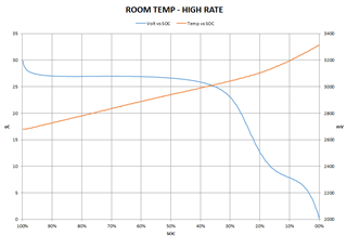

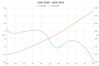

We uploaded the characterization log data from a high-power LFP cell to GPCEDV tool. The application uses quite high discharge currents (~2C average typical, up to ~6.5C average high) over a rather extended temp range (still meeting cell manufacturer's specifications). Unfortunately, GPCEDV is not able to fit all these data with a reasonably low SOC error estimation. We experimented with many different FitMaxSOC%, FitMinSOC%, LearnSOC% values but results are still not satisfactory.
We suspect that the source of this error is cell self-heating at cold (see graphs below). Is it possible to achieve convergence by trimming FitMaxSOC%, FitMinSOC%, LearnSOC% or we shall decrease discharge currents to e.g. 2C / 4C?

  • I am attaching a screenshot which combines the Voltage vs RemCap curves for all of the six characterization measurements.
  • Since you are using 2V termination, the strange shape that is due to self heating and resistance changes in the cell due to stages of graphite and high discharge rates don't matter to much for accuracy, because your termination is still happening in a nicely decreasing portion of the curve.

    Since this is a very high rate discharge, self-heating is a very important factor and it looks like
    high rate voltage actually goes higher then low rate voltage at the end, even though measured temperature increase is only slightly higher.
    Maybe temperature increase is not correctly measured.
    I wonder if location of thermistor and how well it is attached could be improved, or test could run in more realistic thermal
    environment (thermal box) that emulates actual device, so that cooling from the fan of thermal chamber does not interfer with the reading
    of the thermistor.
  • Hello Yevgen,
    Unfortunately, the actual cell pack and its enclosure were not ready at the time characterization began. However, the lug-type temperature sensor was very firmly attached to the cable lug and very close (~ 1cm) to the positive pole. Additionally, sensor was protected against direct air flow from the fan. So I tend to think that temp data are not grossly inaccurate.

    If results above are unusable, I am puzzled on what to do next because it seems to me that CEDV fitting algorithm needs a not only a strictly monotonic voltage vs DOD curve but it also requires these curves not to deviate from a second order polynomial form. If this is true, we should characterize using much lower discharge currents. Is this correct?
  • LearnSOC 1% just means that learning in your system will occure at 1% point. If this is acceptable and system will actually allow to discharge to this point, then it is a reasonable setting - just make sure you also change LeanSOC in the DF of your gauge.
    The rest of the results look reasonable for now.
    For the future it would make sense to use somewhat lower discharge currents to avoid very large IR drops and rises across resistance "humps" in LiFePO4/graphite system, which are not visible at low rates but can be very prominent at high rates as you have observed. You are correct that expected curves have to be monotonic and decreasing, at lest in the portion of the curve between max and min fit settings.
