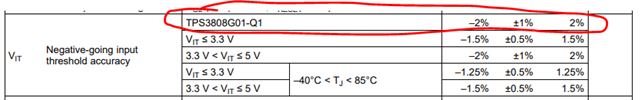

could you please mention whether Vit = 0.405V mentioned is at falling edge or rising edge.
If it is at falling edge then at rising edge will there be hysteresis add on upto 2% ie 8.1mV added you mean at rising edge Threshold is 0.413 to 415V.
Also does Vit has a range in % both in rising and falling edge.
Could ypu please provide the data as soon as possible.
Thanks!
  • Hi Asha,
    For VIT = 0.405V, it is the falling edge when monitoring a voltage rail.  Remember though, the accuracy is listed as:
    The rising edge will have hysteresis that may be up to 3% shown below:
    Below is the VIT range:
    VIT (falling) = 0.405V ---> 0.3969V to 0.413V (+/- 2% for VIT falling voltage threshold accuracy)
    VIT (rising) =  0.40881V to 0.4254V (+3% max hysteresis for VIT rising voltage threshold accuracy)
