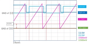

    Below is the result of the customer checking the voltage of the Dead-Time Control Comparator.
    The waveform could not be attached. It becomes an image waveform.
    Dead-Time ends at 0.57V instead of 0.1V. Is 0.57V correct?
    Or is there some other factor?

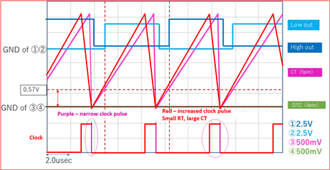

    0.57 V seems high and the DTC pin voltage looks like absolute GND. Try increasing CT and decreasing RT (maintain the same frequency) to slow down the downslope of the RAMP signal. Measure and compare to the waveform you provided. Are these waveforms taken from a real circuit or simulation file?

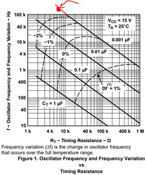

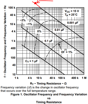

    The oscillator parameters given in the TL494 data sheet are specified at RT=12 kΩ, CT=10 nF, Fosc=10 kHz! Your customer has programmed the oscillator for RT=5.7 kΩ, CT=1 nF and Fosc~180 kHz. I thought we could see the effect on the minimum DT when we change the CT from 1 nF to 10 nF to match the data sheet. We would then need to change RT from 5.7 kΩ to RT=280 Ω but at RT=280 Ω, I_charge=10.7 mA which is too high for the internal oscillator.
    The customers programmed oscillator frequency is off the chart according to:
    And although the data sheet specifies a maximum recommended Fosc=300 kHz, this is most likely for single ended operation, or double ended operation without any certainty with respect to DT. I'm not sure what other features your customer is interested in or is they might be open to an alternate controller, but here is the parametric filtered list of TI Push Pull controllers with programmable dead time feature. Any of the UCC, BiCMOS controllers will be better suited for accurate DT control and higher frequency operation.
