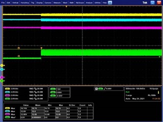

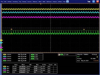

Could you comment on whether the gate waveform of /BATDRV is normal? After adding 3A load to the system, the ripple will become larger, and the battery status is close to full charge.
Is it affected by the input voltage ripple? Because we found that the peak-to-peak value of the VIN ripple voltage is about 2V. Thanks for your support!
CH1: VIN (19V); CH2: VSYS; CH3: VBAT (3S); CH4: /BATDRV

    In order to turn the BATFET on, /BATDRV goes approximately 6V below SRN. Since VIN, VSYS, and VBAT in your waveform all have significant ripple, it is not surprising that /BATDRV has ripple as well.
    Overall, it seems like the ripple is caused by instability with the 3A system load connected, not a problem with /BATDRV itself. The ripple frequency is <10 kHz, which is much lower than the converter's switching frequency, so I don't think the ripple is directly caused by the converter either. What kind of load do you have connected to VSYS? Is it a 3A e-load in constant current mode?

    After reducing the e-load from 3A to 2A, the ripple becomes smaller. The problem only occurs when it is almost full charged (with a capacity of 99% to 100% from gauge) and the fast charge current is set to 1.65A.
