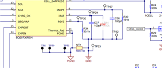

  In evaluating this part I have not been able to understand the logic behind the input current limit function (IIN_DPM / IIN_HOST). Input current sensing and limiting is described in the datasheet in terms of a register which does not exist in the register descriptions, nor anywhere I can find on Google (EN_FAST_5MOHM). The BQ25731 datasheet also seems to have the same issue.
  The part supports a charge current up to 16A, so I am confused as to why the input current sense's maximum clamp is 10A, as there is no other source of charge current, and the DPM loop maximum current is similarly limited. I intend to disable the input current regulation loop and rely only on VSYS regulation in order to overcome this limit while using a 5mOhm resistor in order to ensure a large enough signal for the inductor current regulation loop. However it would help if the datasheet was rewritten a little to make this design decision clear and remove reference to this missing register.
  I would appreciate it if someone could confirm my understanding is correct, and that the part will behave as expected.

    Thanks for reaching out. Yes, you can disable the IINDPM loop and rely on VINDPM for input source protection.
    We have the BQ25730 EVM for evaluation if necessary.

  • Hi Paul,
    I will take a note and discuss internally. However, it is not something that can be done in a day or two.
    For now, please disregard that bit. You can take it as case 3 in the datasheet:
    On the EVM, we also uses IADAPT pin resistor > 160k. In generally, the more integrated an IC is, the more you want to refer to the EVM.
    Peng
