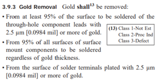

I would like to know if the termination finish is ENIG. Would gold removal be required for this part per IPC J-STD-001 (i.e. gold embrittlement mitigation)?

Thank you, but this doesn't specify gold thickness. Can you confirm the Au thickness? I'm assuming the finish is electrolytic NiAu as opposed to ENIG... so gold removal is required, correct?

You are correct, it is electrolytic finish with a gold thickness of ~ 0.45 um for UCC20225. You only consider to remove gold if thickness exceed 2.5um per IPC/JEDEC J-STD-001. The following image is from the IPC/JEDEC J-STD-001 standard.

Thank you for the information! I think in this case, gold removal would be required based on the second bullet point, "surface mount components to be soldered regardless of gold thickness".
