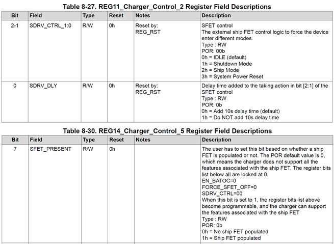

I would like to test the "Ship Mode" on the USB-PD-CHG-EVM-01. In the datasheet it’s not clearly written if the Ship FET must be present. The datasheet says:
My understanding is that a Ship FET is not necessary but preferred because the leakage current is lower with a Ship FET.
So I set the registers from
reg=0x0F name=Charger Control         size=6 data=0xA2 0x85 0x40 0x00 0x01 0x16
    SDRV_CTRL             = 0
    SDRV_DLY              = 0
    SFET_PRESENT          = 0
to
reg=0x0F name=Charger Control         size=6 data=0xA2 0x85 0x45 0x00 0x01 0x96
    SDRV_CTRL             = 2
    SDRV_DLY              = 1
    SFET_PRESENT          = 1
as in the datasheet
But the system voltage doesn’t drop, so the BATFET is still on.
I checked the forum and found two interesting posts:
As I understand now, I cannot test the "Ship Mode" on the USB-PD-CHG-EVM-01 because there is no Ship FET populated?
So I need to design an own PCB to test it?

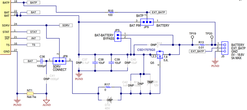

  • Oh, here is a part of the schematic of the USB-PD-CHG-EVM-01:
    If you would like to test the ShipFet capability you have two options:
    1. Try out the BQ25792EVM.
    2. Make your own PCB.
    The USB-PD-CHG-EVM-01 does not support ShipFet capability. In addition, if you make a design with the TPS25750 you will have to control the ShipFet via I2C.

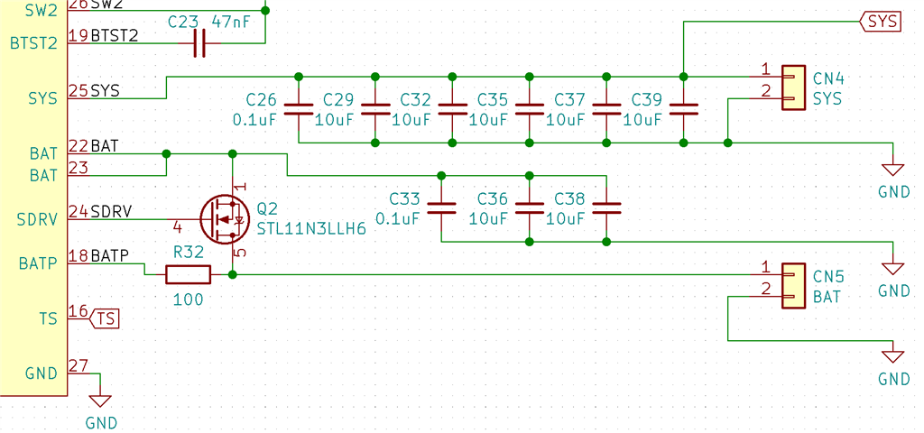

  • Hi Mike,
    I need to design my own PCB anyway (just the BQ25792 without the TPS25750). I just copy/paste most of the USB-PD-CHG-EVM-01 schematic, but now that I need a Ship FET I took the BAT/BATP/SDRV from the BQ25792EVM schematic.
    Part of BQ25792EVM schematic:
    Part of my own schematic:
    Part of my own PCB:
    Does that make sense?
  • The Ship FET looks good on the schematic.
