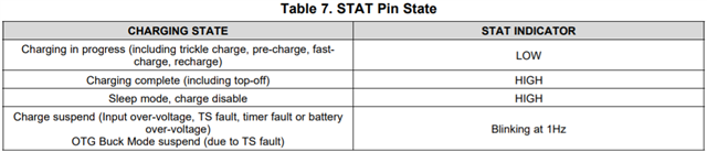

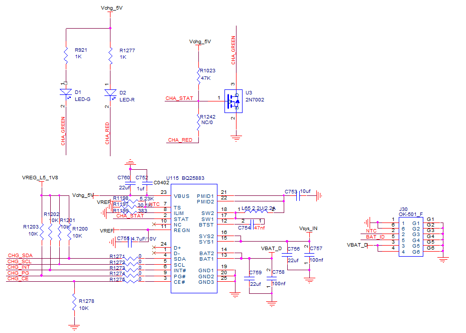

The charging chip is bq25883,
When the device is shut down, the plug-in adapter will light up the green light first, and then the red light (the measured stat has 800ms high level);
The problem is that normally, the red light should always be on. Why does the stat have 800ms high level, causing the green light to flash
