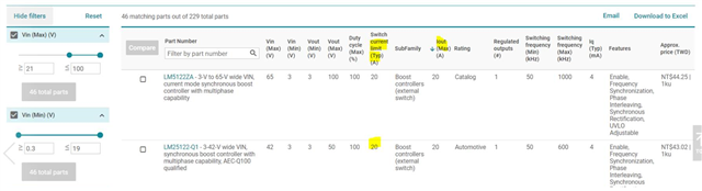

My customer would like design boost application for the following conditions.
Vin:20V
Vout 24V/ Iout 20A
Are LM5122 and LM25122 able to support the requirement? Suppose to the current rating which depend on the MOSFET, is that right?
 from the webench, LM5122 is ok for 25A design. (https://webench.ti.com/appinfo/webench/scripts/SDP.cgi?ID=42CDAF14008F7A80 )
However, from the product search list, it show both device only can support max current is 20A.
BR,
