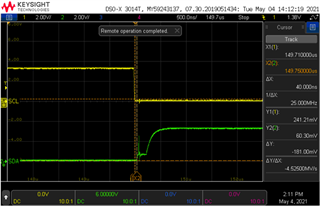

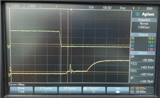

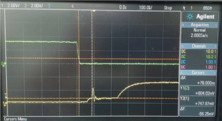

The LP5562 i2c timing spec for data hold time minimum is 50ns but customer only got 40ns. In DS figure2, it seems the measure start point is from 0V?
From i2c spec, the data hold time is measured from 30% of fall time. By measuring from that, it can pass 50ns requirement.
note: i2c communication is no problem
Could you please clarify what’s the correct data hold time measure start point defined in our DS?
The second question, the i2c spec data hold time minimum is 5ns, but why LP5562 need 50ns? Is it a must meet requirement?
