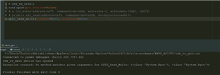

Hope you're doing good!!! the Fusion API is working fine for send_byte(), write_byte(), and i2c_write/read() functions. But it's not working for this gpio_read_write() function and that got raised an exception. the example code and error snippet has attached here FYR.

  • Hello, the expected prototype (from using the help() function in Python) is:
    GPIO_Read_Write(...)
        GPIO_Read_Write(self: SMBusAdapter, readMask: Byte, writeData: Byte, readData: Byte) -> (SAAStatus, Byte)
    Personally I've not used this function much, and usually use the Set_Control and Get_Control methods to control/read GPIOs.
    Get_Control(...)
        Get_Control(self: SMBusAdapter, control_line_number: int) -> LogicLevelResult
    Set_Control(...)
        Set_Control(self: SMBusAdapter, control_line_number: int, control_on: bool) -> SAAStatus
  • Thank you, !!!
    It has working now using Set & Get_Control functions.
