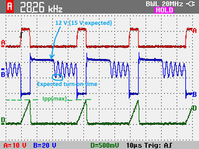

I designed 50 W flyback with 15 V output voltage. I have got quite a good regulation at loads up to 33 W. But when I connect extra load (total of 44 W) the power actually decreases as decreseses switching frequency and output voltage. Please see the waveforms (Red - Gate signal, Blue - Vaux voltage, Green - Vcs signal).
Secondary winding has the same number of turns as aux winding. So Vaux is close to Vsec. As you can see (blue waveform) Vaux = Vsec is approximately 12 V. In my design Rs1 = 50 k, Rs2 = 18 k. So voltage at Vs pin should be 12 * 18 / (50 + 18) = 3.18 V (much less then expected 4.05 V).
The Vcs signal has a magnitude of 0.75-0.8 V corresponding to Ipp(max). And the output frequency is set to approx. 28 kHz. Note that at lighter load (6.8 Ω) I get higher frequency than at higher load (5.1 Ω).
The question is why the frequency is reduced after connecting extra load? As I understand while Vs pin is below regulating level of 4.05 V the output signal should be switched at the first or maybe second valley (Expected turn-on time at blue waveform) and frequency should increase as well as output power. According to control law frequency can NOT be below 33 kHz while current is maximum.
The question is what exactly prevents UCC28711 from increasing the frequency? Or maybe what prevents UCC28711 from switching at the first or second valley providing at least 40 kHz and enough power to keep voltage at 15 V.

    Your waveform does show that you are operating at a low frequency  and in DCM.  You are actually operating in the lower FM band.  So the UCC28711 should be controlling the VS pin to 4.06 V at the sample point.

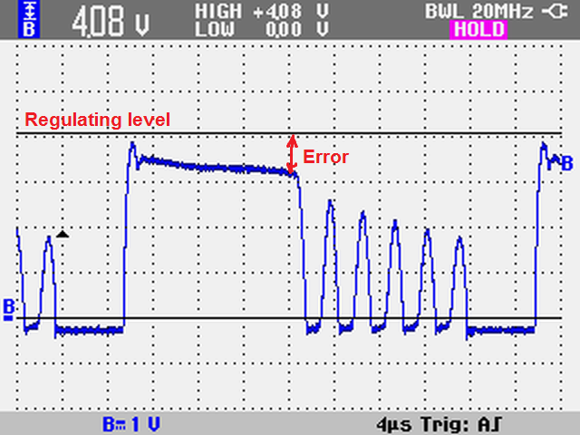

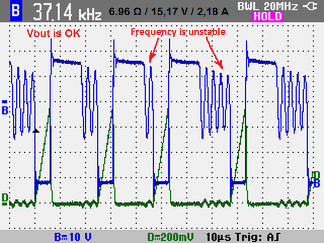

    Lets look at VS pin waveform and again Vaux and drain current (different loads).
    1. Load 8.65 Ω, Vout = 15.14 V, Iout = 1.75 A, P = 26.5 W
     VS-pin waveform
    2. Load 6.96 Ω, Vout = 15.17 V, Iout = 2.18 A, P = 33.1 W

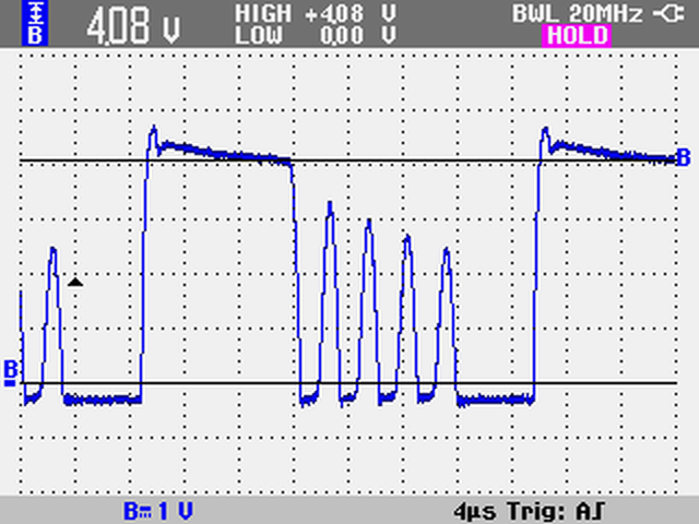

    3. Load 5.27 Ω, Vout = 11.78 V, Iout = 2.25 A, P = 26.5 W. Vs signal does not even get close to regulating level of 4.06 V.
    Replacing the IC does not solve this problem
    I am wondering if the issues is your FET is not turning on fast enough which would limit your duty cycle.
    When VS is below 4.06V at the sample point it should  initiate a gate drive pulse at the first or second valley after tDamg has timed out.  Please note that the UCC28711 will  sample three switching cycles before adjusting the peak current and/or off time to adjust the duty cycle.
    Your last two waveforms show that VS is well before 4.06V and does not turnon the FET until after 5 valleys after tDmag has timed out.  The UCC28711 only had 25 mA of gate drive current available to turn-on a FET.  Refer to the block diagram in section 8.2   If the FET you are using gate capacitance is too large it may cause this issue.

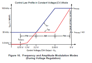

    The below waveform is operating at 28 kHz the converter should be operating the lower FM band and VCS should be controlled to  VCST(min) = 195 mV.  Your waveforms shows that VCS is controlled to VCST(max) = 780 mV.  I think your issue is that your design is violating control law.  While controlling VCS to VCS(max) the design should be operating above  33 kHz in the upper FM band VCL is between 3.55V and 5V (Control law Diagrams internal voltage amplifier outputs).
    For the UCC28711 work properly when CS is controlled to VCST(max) the design needs to be switching at greater than 33 kHz.  If not the controller will have issues regulating the output as you are observing.

    Datasheet says: " DMAGCC is defined as the secondary diode conduction duty cycle during constant-current, CC, operation. It is set internally by the UCC2871x family at 0.425."
    Secondary diode conduction duty cycle (tDM) can not be longer than 0.425 of switching period. Hence the switching frequency can not be higher than 0.425/tDM. While tDM = 15 us, fmax = 28,33 kHz. Exactly like we see it in the first waveform.
