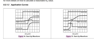

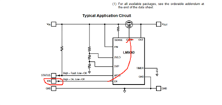

When EN=high, Gate PIN has a signal output, what is this time?What is the time delay?
When EN=Low, Gate PIN has no signal output, what is this time?
thanks!

The path delay from EN to GATE is in the order of 5us (typ). However, note that the time to turn-on or off the external MOSFET depends on the MOSFET gate capacitance.
Let us know your system use case details and why this parameter is important.
