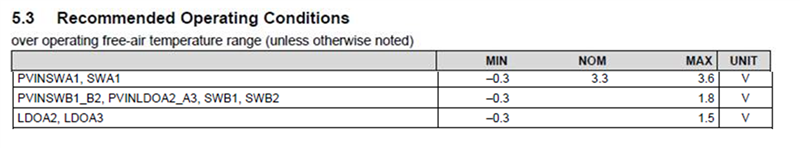

Table in Chapter 5.3,  Recommended Operating Conditions:
PVINSWB1_B2, PVI_LDOA2_A3, SWB1, SWB2 shows a maximum voltage of 1.8V,
resp. PVIN_SWA1, SWA1 max 3.6V:

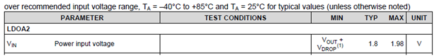

Chapter 5.9 lists LDO2, LDO3 with VIN max. 1.98V (=Pin PVINLDOA2_A3):

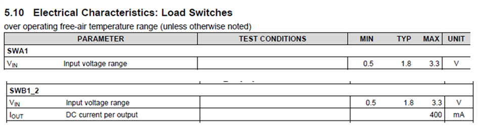

Then in chapter 5.10
SWA1. VIN max 3.3V (= PIn PVINSWA1)
SWB1_2: VIN max 3.3V (= PIN PVINSWB1_B2)

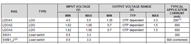

In the Summary Table 6-1:
Input Voltage:  1.98V for LDO2, LDO3
Input Voltage: 3.3V for SWA/SWB

    table 5.3: Recommended Operating Conditions:
    5.10 Electrical Characteristics: Load Switches:
    table 6-1:

  • Hi Hans,
    For Intel Apollo Lake, SWB1_2 is used for V1P8U, so the recommended input voltage is 1.8V. LDOA2/A3 are set to 1.2V/1.25V for most OTPs, so the recommended input voltage is 1.8V. So Table 5-3 is correct - recommending 3.3V would potentially damage boards and lead to high thermal loss.
    It does not say that they can't use 3.3V input though. It is just describing the recommended condition for use with Intel Apollo Lake. 3.3V is a valid input for both, assuming they aren't being used.

    The load switches can support up to 3.6V per the absolute max table.
