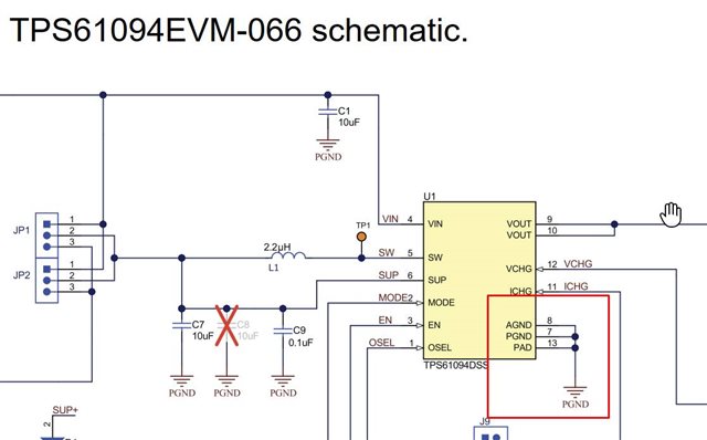

TPS61094: AGND connection
Part Number: TPS61094
Does the AGND and PGND connected internally inside the chip?
In the datasheet layout recommendation the AGND and PGND are not connected on the PCB but
In the EVM the AGND and PGND pins are connected on the PCB
Which layout option is recommended
Datasheet
EVM
