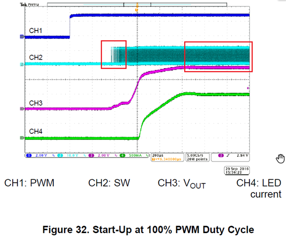

I want to know the reason for duty change of SW waveform in figure 32 in datasheet. Why does the duty of SW waveform change after the output becomes stable from starting up? Thanks.

Sorry for replying so late. During start-up, the voltage of Rsense keeps rising until it reaches 200mV and internal EA output also varies at the same time, which results in various duty cycle. After Vsense reachs 200mV, the EA output becomes stable.
