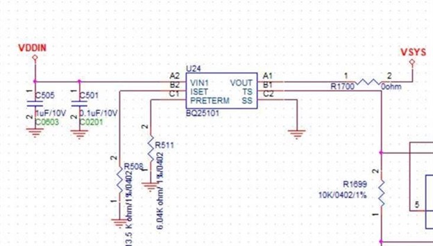

Hey Expert,
when VSYS=3.3V does the charge current will below 20mA? R508=13.5k ohm. so I fast charge=10ma
I saw the V lowv=2.4~2.6. on datasheet. so I will say no. when Vsys=3.3 still in fast charge right?
Thanks for your support.
Jim

Hello Jim,
When VOUT is at 3.3V the device would be in fast charge, yes.
One comment on your schematic is there should be a capacitor on the VOUT pin of 1uF.
Nick
