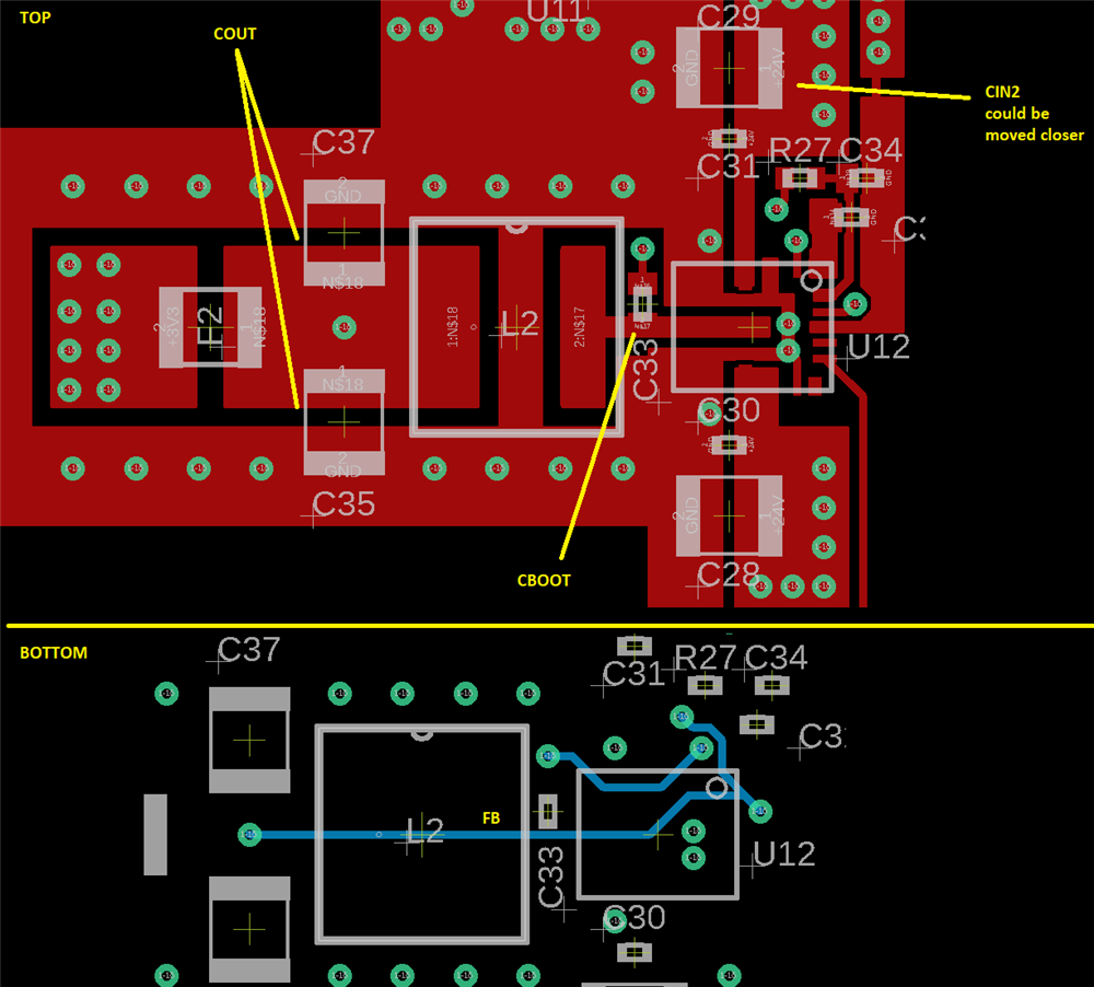

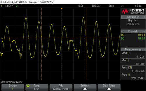

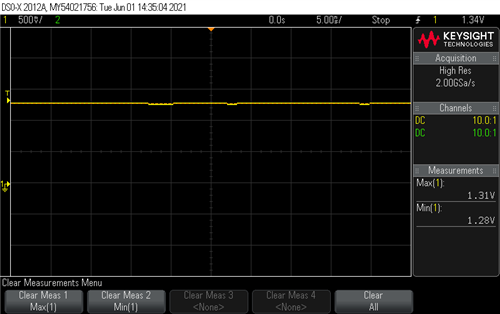

I used WEBench for a 3.3V regulator using the LMS3635-Q1. On implementing it on board we arent seeing any output from it.

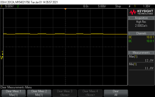

I ensured that it was getting 12/24V input and the EN signal was high.

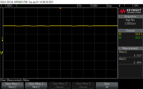

Also checked the voltage at the VCC pin for the internal LDO. It was 3.05V suggesting the IC is indeed powered on.
I'm about to pull my hair out. What am I doing wrong here?
