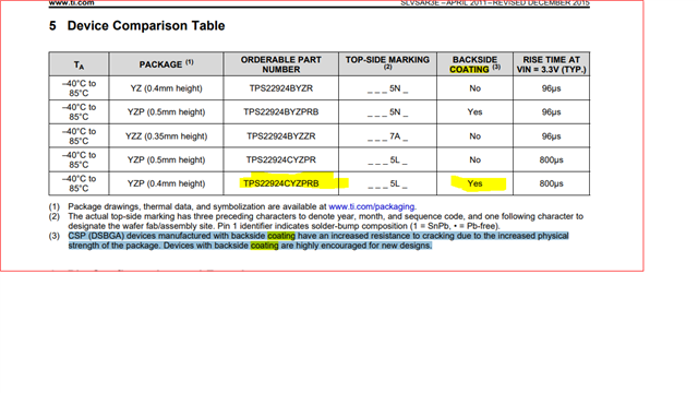

Hi
Please help to check what difference for the following two items ?
And the TPS22924CYZPRB can be replace the TPS22924CYZPR ?
Hi Gareth,
The backside coating is a thin polymer layer. This helps add a bit of physical strength to the package. From an electrical perspective, the devices are interchangeable.
Shreyas
