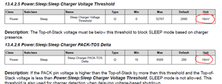

I see a mismatch between Reference manual units & BQStudio
Can you confirm which are the current parameters units, from Power Sleep configuration?
Power:Sleep:Sleep Charger Voltage Threshold
  (Default values are 20000 & 2000 in mV units, instead of 10mV based)
To have, for example the Sleep Charger Voltage Threshold to 22000mV, I have to  send a 22000, instead a 2200 (based on 10mV units).
Thanks!
  • Hi Del,
    The units are 10 mV, when stored, so the values are:
    2000 10 mV is 20000 mV or 20V
    200 10 mV is 2000 mV or 2V
    BQStudio understands the conversion and shows you the 20000 mV and 2000 mV.  You can write the mV value you want in BQStudio.  If you are writing to memory with your MCU you must calculate the value in 10 mV.
