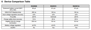

Dear Support
I designed our battery charger with BQ25606 and it works good.
We don't use USB function. +D,-D open. power supply connect VBUS and VAC. and OTG pin connect GND.
Can we mount BQ25616 instead of BQ25606?
I think BQ25616 support boost for OTG, another points are not different with BQ25606.
Because there are no BQ25606 stocks anywhere.
