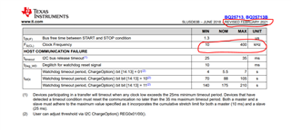

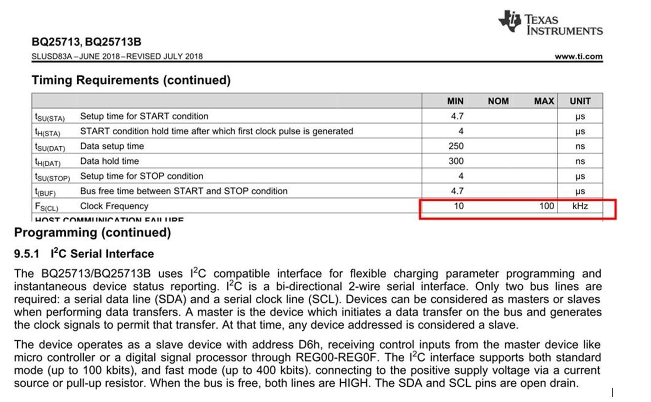

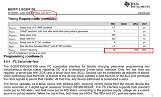

Hi Team,
About the charger controller BQ25713RSNR , my customer's actual I2C bus timing is running under Fast mode (400KHz) ,but it only provides Standard mode(100KHz) timing characteristics in datasheet .
Would you able to provide Fast mode's timing characteristics for reference?
