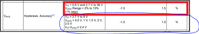

PS37F010122DSKR device is 0.8mV threshold, Hysteresis 2% on both ch1 and ch2 as follows:
  • CH1 : OV OD H : 0.8mV(Typ)
  • CH2 : UV OD L : 0.8mV(Typ)
  • VHYS = 2% = 0.016mV (Typ) on both CH1 and CH2
What do you mean Hysteresis Accuracy on the datasheet P.7 as follows?
0.016mV*±1.5% distribution????   I am confusing.  Please let us know.

  • Hi M.Hattori-san,
    • CH1 : OV OD H : 800mV (Typ)
    • CH2 : UV OD L : 800mV (Typ)
    • VHYS = 2% = 16mV (Typ) on both CH1 and CH2
    I believe you had the wrong values for the threshold voltages.  Both threshold voltages are 800mV and the VHYS is 2% of 800mV which is 16mV.
    Therefore, for OV option, the threshold is 800mV (typ) for the output to assert and 784mV (typ) to deassert the output.
    For UV option, the threshold is 800mV (typ) for the output to assert and 816mV (typ) to deassert the output.
    The hysteresis accuracy can be +/-1.5%.  If the 2% hysteresis accuracy is chosen, the worst case hysteresis can result in +/-0.5% which results in:
    OV: 796mV (4mV of hysteresis - worst case) to deassert the output
    UV: 804mV (4mV of hysteresis - worst case) to deassert the output

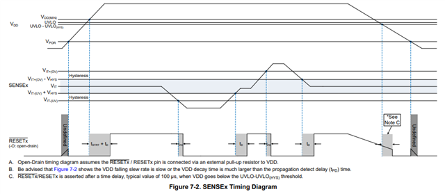

    Also, please see graph from TPS3704 to help you understand what I just mentioned.  The TPS3704 is a UV-OV window voltage supervisor where as the TPS37F is not a window voltage supervisor but an OV and UV 2-channel supervisor.
    I help my explanation above answers your questions.  Please let me know if you have any other question.

  • Hi M.Hattori-san,
    I wanted to add one more bit of information regarding the hysteresis for TPS37B.  The TPS37B also has fixed hysteresis and the hysteresis is only available for thresholds up to 8V.  It is in the second row shown below where I have circled it in blue:
    Please let me know if you have any other questions.  If not, please click on "resolved" to close out the thread.  Thank you and good luck to you!
