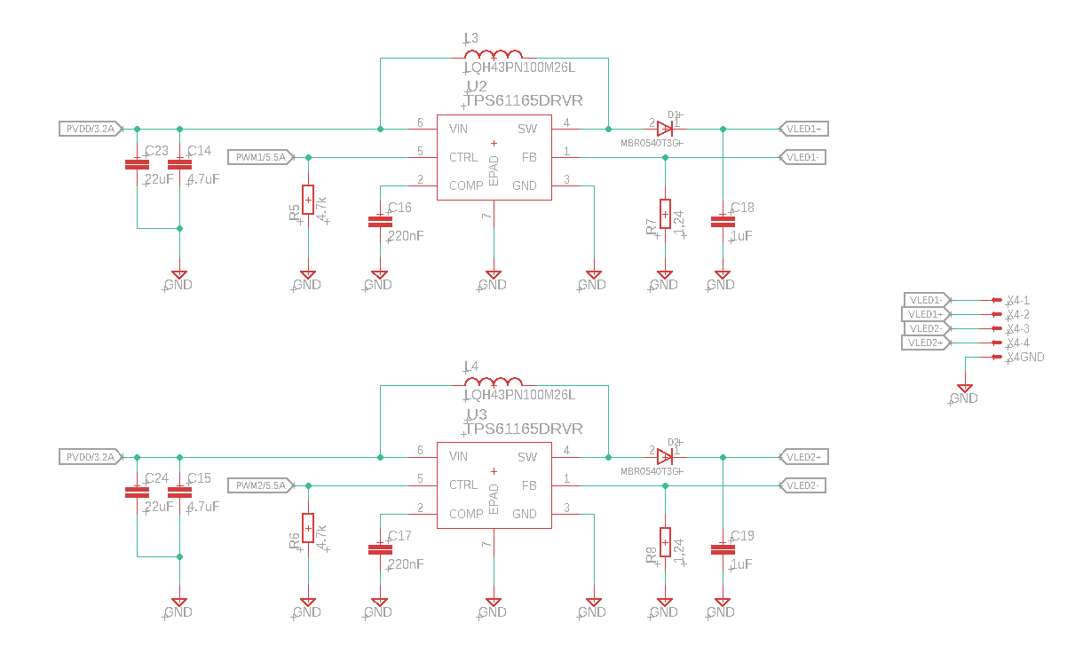

Hi everyone,
I've got a question regarding our implementation of the TPS61165, which we use to drive 8 leds in parallel (2x4). The current per line is 160mA, so 320mA in total per driver, with 4 leds of Vf = 6V, so Vout = 24.2V if we had the VFB of 200mV, with Vin = 15V.
Below is the schematic of our implementation, with two drivers (each one control a different chain of white leds):
From my calculation, I've got a ripple current of Ip = 494mA, which is more than 100% of the leds current. Am I missing something here? Can someone validate that I didn't make any mistake in my choice of components? Our prototypes work well, but I would like to validate this before going to production.
Thanks for reading me,
Yoann
  • Hi Hardy could u help in this case
  • Hi Yoann,
    This is inductor peak to peak ripple current, which is the current flow through the inductor but not LED.
