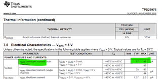

Hi Team,
My customer found that our TPS22961 VBIAS quiescent current & VBIAS shutdown current are the same, is it correct?
Because when we check the TPS22976's datasheet, it show different parameter of them.
Thanks!!
