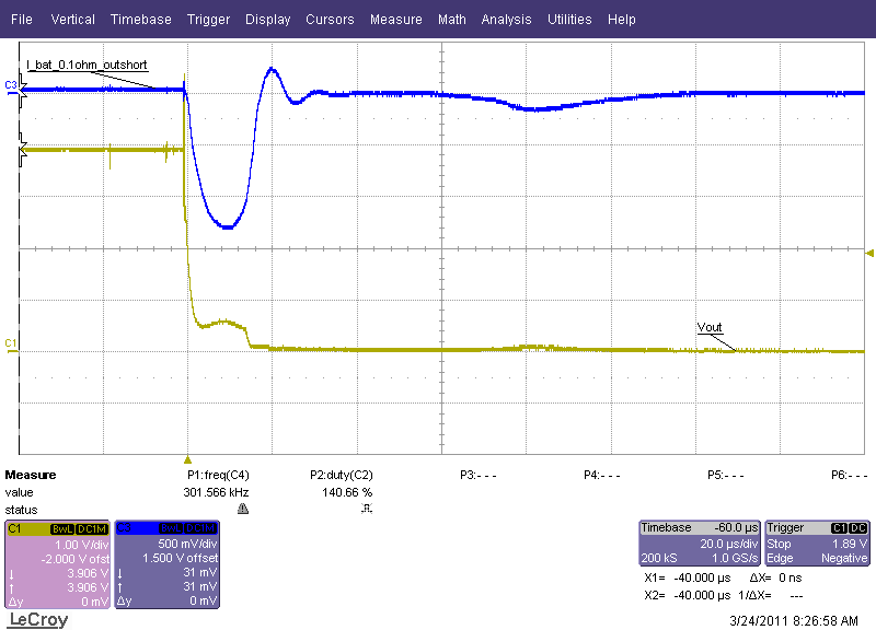

    Answer 3a) This is a current source so if a short is applied the current never increases so it is not like a critical issue where high current is delivered and one wants to minimize the time.  The comparator and logic are in the microseconds, but the control loop drive to turn the FET off is in in the low miliseconds range, <10ms.
    Answer 3b) if input is applied then the bat short circuit delay is expired and the delay is 10us to start turning off the FET and another 10us until the BAT FET is off. see photo.
    If just the battery is applied and a short on the out pin is applied then the time is a function of the DPPM capacitor.  After the DPPM pin charges to 1V (starts to charge after short is detected) then it takes 20us.....so the dominate time is the time for the DPPM pin to charge to 1V.
