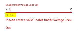

Hi Team,
The TPS552882 Webench model returns an error when setting a custom EN UVLO, regardless of value. Can this be fixed on the next rev of the model?:
Antonio
Hi Team,
Antonio
Hi Antonio
Seems minimum and maximum range values got swapped for this feature and hence the issue. We will correct the same and let you know once fix is available on ti.com (tentatively by first week of July).
Best Regards
Bhushan
Hi Antonio,
We have fixed this issue. The fix will be available on ti.com by mid of 4th week June.
Thanks & Regards,
Praveen
Hi Antonio,
The fix is available on ti.com
Thanks & Regards,
Praveen
