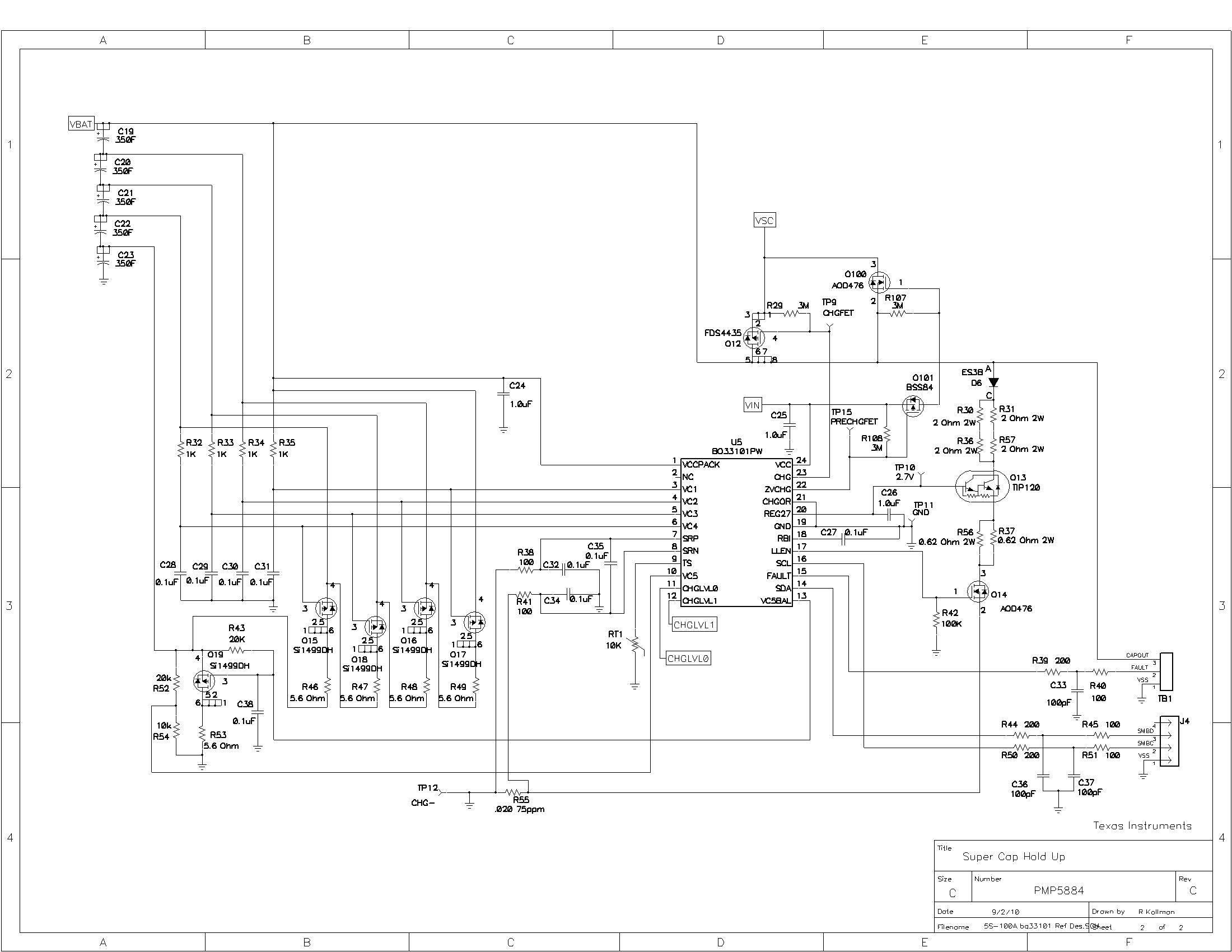

  • John,
    The circuit for the 5S/100A supercap manager is attached. We also have an accompanying circuit available for a buck-boost (actually SEPIC) charger and high current ideal "oring" circuit if you are interested.
    In this case, we had to use two charge FETs to get the job done without a big heatsink. Q100 turns on when the cap stack voltage is under 5V, then Q12 takes over at higher voltages. VSC is the output of the charger. Notice that only the learning load current passes through the sense resistor R55.

  • Thanks for the holdup schematic! I'd be very interested in seeing the diode or'ing schematic too. In fact, seeing any schematics using the bq33100/33101 helps with my understanding of the chip and the ways it can be used. If not too much trouble, please also post the schematic for the circuit that's for the SEPIC charger.
    I'll be taking a much closer look at the 5S/100A circuit but I immediately noticed it uses a bq33101. Any info available on the differences between it and the bq33100?
  • John,
    Charger and or'ing circuit are attached. The bq33101 is a minor spin in that it provides the dual charge FET control, and doesn't have current safety features since the current sense resistor is for the load current only.
