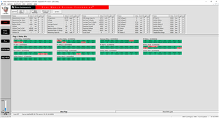

BQ20Z655: DSG turn off after charging
Part Number: BQ20Z655
Hi, Sir:
I tested the bq20Z655 for 2s application.
After ox46 to turn on the CHG & DSG mosfet. I can measure the Pack output voltage.
I charged the pack, charging is OK.
After charged, the dsg turn off, so pack output voltage =0 V.

after charging, dsg turn off
How to solve ?
