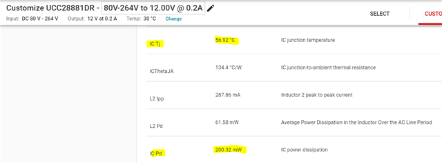

    1.When I use Vin=264V to calculate Pd, Pd will be around 2.144W. However, Webench shows only 0.2W. I think the value in Webench is more reasonable, could you confirm which is correct? Formula or Webench?

    If you are talking about Webench, could you point it out specifically? Below is the Webench link I used.
    https://webench.ti.com/appinfo/webench/scripts/SDP.cgi?ID=CAAA52A11B37AFBE

    And I have another two questions about Webench.
    1. UCC28881 on Webench is high-side buck topology, but customer is using UCC28881 as low-side buck topology,
    will the simulation result for Pd be the same for both high-side buck topology and how-side buck topology?
    2. Will the external components value(resistor, capacitor, inductor) affects simulation result for  Pd? I'm asking because the formula Mike provided have no parameter for external components value but the Pd simulation result actually changed after I changed the value of Cfb.
