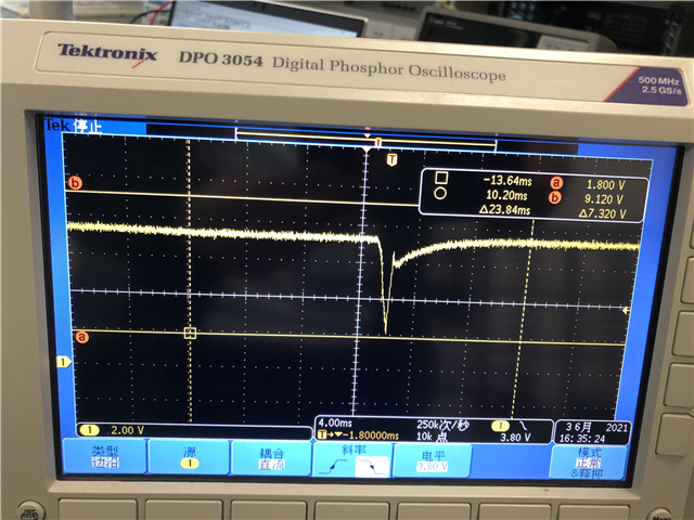

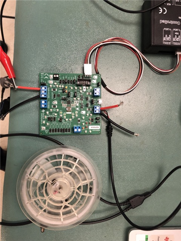

My customer are  testing the BQ25792EVM OTG mode to drive a fan as follow show. But it has a startup problem.
Test condition:
VBAT connect a 7.5v DC power, VIN1 connect a fan. OTG reg voltage:5-13V
Test problem:
Disable EN OTG MODE and then enable EN OTG MODE by change  REG12 register, when the OTG reg voltage less than 10V, it can startup, but when the OTG reg voltage set to larger than 10V, it can not startup. I test the VBAT voltage when OTG reg voltage set as 13V, test result as follow, the moment the REG12 register is written, there a voltage drop in VBAT, and the fan cannot start up and VIN has no voltage. Can you tell me why BQ25792 cannot startup when OTG reg voltage set to larger than 10V? Thank you!
  • When it startup with OTG voltage that less than 10V and increase OTG voltage to 13V after it started-up, there are no problem.
    Can you please describe your setup more? I enabled OTG from 7.5 BAT, attached 10 Ohm load, then enabled ACDRV1 and the converter started outputting 13.94 V at 1.37 A. I am not seeing the issue with the battery. Please provide more information.

    I am thinking the inductive load of the fan is causing the OTG UVP to happen. You need to make sure the input is regulating to the OTG voltage before you attach the fan. Is there any way you can turn the fan on after the input is regulating the desired OTG voltage?

    I am sorry that I am not describe the question clearly. I mean that customer requirement is the fan is inserted and then enable OTG to drive fan. However, as you answer above, the fan may as inductive load, so it may have star-up problem. But now, the customer has a prototype that use BQ25792 as charger and the prototype can start-up when fan is inserted. He didn't know why the prototype can solve the star-up problem, if we have method to solve the start-up problem? add a extra hardware circuit or other method can solve the inductive effect? Thanks.
    I want to make sure I am on the same page. The BQ25792 EVM doesn't let you start up, but your prototype does? Please fully describe the differences between the prototype and the EVM as well as all the operating conditions, such as battery voltage etc. I need to see the differences to help explain the behavior.
    Mike Emanuel
  • Hi Mike,
    The prototype customer has is sent by his EC that is for test only, so unfortunately the customer do not have the schematic in this time,  the test condition is same when use BQ25792EVM or prototype that VBAT connect a 7.5v DC power, VIN1 connect a fan. OTG reg voltage:13V. I also wonder why it can be different, but I am sure the start-up problem described above is solved in prototype.  So I am wonder if you have some idea about the start-up problem when use BQ25792EVM?
    or if you don't have the fan, the start-up problem of BQ25792EVM also occur when  an e-load is attached (VBAT connect a 7.5v DC power, VIN1 connect a CC mode 1.5A or CR mode 7 Ω e-load. OTG reg voltage set as13V. and the current didn't exceed the limit), if there is method can solve the start-up  problem when use  BQ25792EVM+e-load?
  • In order to better answer your question, I am going to need to see the prototype schematics and how they differ from the BQ25792EVM. I observed in the lab that I could not start up OTG if I applied the 1.5 A CC load before OTG was enabled. I had to enable OTG then apply the load.
