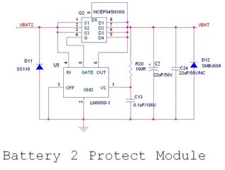

LM5050-1 is application in two battery in parallel, it acts reverse protection function,but now the function is failure, the schematic is as attached,please kindly help me check,many thanks~

Hi Cooper,
I understand that you are using 2x LM5050-1 to achieve ORing between two batteries.
What do you mean by 'reverse protection function' ? Do you mean reverse current blocking ?
Also, please elaborate more on the type of failure and the condition at which failure occurs.

I sent the schematic again, you are right that i am using 2x LM5050-1 to achieve ORing between two batteries;
now refer to P14 figure 21 or 22, but I found the issue occurs: connect battery one , no connect battery 2, but I found batery 2 voltage that there is 5.5V value , it should be zero; however, occasionally, I found the battery 2 voltage is 24V. so the LM5050-1 is no working.
note, the LM5050 power supply connects to the output.
