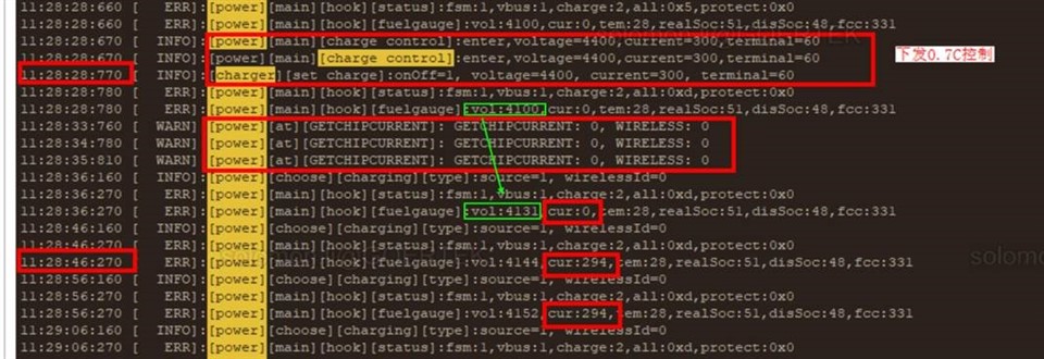

Hi team,
Customer use BQ27426 in their project. Now they report one issue about the current detect delay.
As could see in the following log, they send charge command at 11:28:28:770, they measure use a external probe, it shows the current coming out after this command; after ~8s, they read the current, it report 0mA, voltage does change; then after  another 10s, they get the correct current.
They total delay is ~18s. The voltage does see immediately change when read, so questions is why their is 18s delay? How should we further debug this?
Thanks and Best Regards,
Will
  • Will,
    When the gauge is in sleep mode the current measurement is delayed to happen only every 20seconds. The slow down in measurement is how the gauge saves power. So this is an expected delay (it will vary) depending on when current is applied in the measurement cycle
    Eric Vos
  • Hi Vos,
    Does all the measurement take every 20seconds? I find the voltage is changing from 4100mV to 4131mV with in 10 second, so does it mean the part already get out of sleep mode? Could you help share more comments?
    Will
  • Will,
    Voltage updates at a faster rate in sleep mode. By default it updates every 5 seconds.
    Eric Vos
