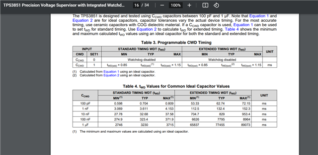

My customer are looking for WDOG IC for their project.  Their application are as below.
I have found TPS3851 but the time out cannot achieve higher than 3min. Could you kindly guide suitable solution? Thanks.
  1. Don’t need enable pin
  2. Time out window > 3min
