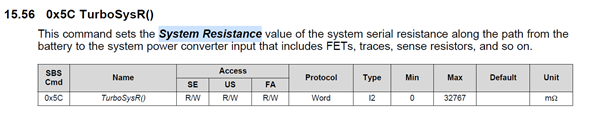

1) System Resistance:
1.1) It is mentioned in:
1.2) it is mentioned in chapter 6.8 TURBO Mode 3.0, that it is important parameter.
1.3) and here:

My questions are:
a) Am I right, that Pack Resistance = Interconnecti Resistance + System Resistance + all Cell internal resistance? (Where Cell Internal Resistance parameter is stored in BMS Studio?)
b) Is only System Resistance taken into account for charging Loss compensation?
c) Are both System Resistance and Pack resistance taken into account by TurboMode mechanisms?
d) Where is used Interconnect Resistance.?

  • Jurijs,
    Here is the best way i can describe these three resistance values imaging you have a battery pack stand alone. This pack has a connector with Pack+/- that you click into your system.
    1) System resistance is the resistance from the battery connector to the endpoint where you need the voltage to stay above min_sys
    2) Pack resistance is from the same connection point as 1 (note to only count the connector resistance once) and the battery stack terminals. this includes the positive side and the negative side (sum'ed up)
    3) Interconnect. This is the resistance between the individual cells. So 1P to 2N for example.
    Turbo mode on a high level added all these resistance up to compute a "total" resistance which allows us to know how much current you can apply to keep the voltage at the end of the system resistance parameter above min sys voltage.
    Hope this helps.
