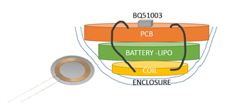

I am using the BQ51003 Qi WCP 1.2 compliant charger.  Values on the schematic are not the ones being used now that was based on the EVM board for the BQ51003. The device is enclosed in a 1mm thick PLA 3D printed enclosure with a coil WR222230-26M8-G 27.20uH facing the plastic, ferrite touching a battery, and the PCB on top of it.

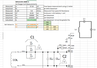

I followed the steps to calculate the C1, C2 matching capacitors to tune the coil.
1. Measured the coil outside the enclosure free space = 27.20uH
2. placed the coil in the enclosure with all the components, battery and board.  Measured 25.92uH
3. Used the equations provided by the datasheet, and computed C1 to be 97.72nF - used 100nF.  C2 calculated as 940pF, used 820pF||120pF = 940pF

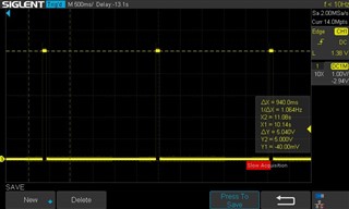

5.  I place the device on the mat, and the mat starts blinking and blinking.  I put the scope at the RECT output, and I see it going up and I see also modulation like.  the LED connected at the output OUT blinks but won't go solid like when I put my cell phone on it.

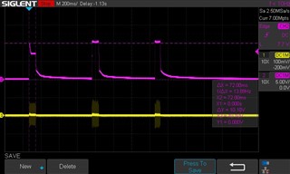

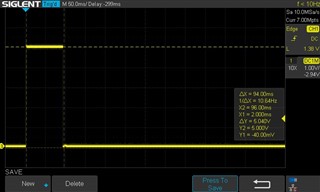

Added a resistive load to the OUT pin at the decoupling capacitors.  The output ON TIME is 94ms every 2.5 seconds. it will not lock on always ON.  The Status LED blinks as following the pulses but it will not stay ON.  Any ideas what is happening?  is it communications, tuning, or otherwise?  Is there anyone that could help me resolve this?
VRECT  Magenta trace at the output decoupling caps of VRECT. the voltage swing is high.

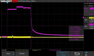

Instrumented better the VRECT capture .  Voltage appears to reach 10.10V approximately  See scope shot of VRECT.  VRECT magnitude ~10V, 70msec duration, and repeats around 800msec...

    Would you be able to show the waveform at VRECT?

  • Anthony,
    I have put the VRECT waveform reaching 10V.  Can you describe the proper way to measure Ls'?  do you need to put my device on top of the TX charging pad and measure?  I don't have a 1Vrms L/C meter. I am using this one https://www.amazon.com/UCTRONICS-Precision-Capacitor-Inductive-Capacitance/dp/B0856RCWBJ/ref=sr_1_1?dchild=1&keywords=UCTRONICS+High+Precision+Handheld+LC+Inductor+Capacitor+Tester%2C+Inductive+Capacitance+Meter+Kit%2C+1pF-100mF%2C+1uH-100H&qid=1623101912&sr=8-1

    The VRECT swing does look high but as it does not exceed the 15V OVP point, this should be fine. This could be a communication error.
    We can try and adjust the COMM 1&2 capacitors. Can you try the following values:
    • Changing COMM 1&2 capacitors to 47-nF?
    • Changing COMM 1&2 to 10%, 20%, and 30% of the series capacitor (C1)?
    Anthony Pham

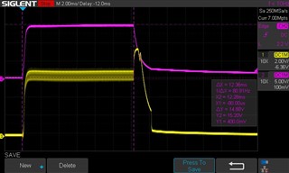

  • Hello Anthony... I replaced the capacitors COMM1 and COMM2 to 47nF  Here are the results.  About 14V in VRECT. The pad continues blinking and won't lock solid LED. I will make the following changes and try
    I will post the results with

    Here is VRECT (Magenta), VOUT(YELLOW) with COMM1, COMM2 @ 10% of C1 or 8.2nF in both sides.  It does not lock

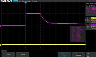

    Here are the VRECT for 20% of C1 or 16.4nF on COMM1 and COMM2.  The charging pad still blinks and sometimes I noticed the VRECT pulse time was longer than 81msec than what is shown in the image- in this condition the charging pad was blinking faster short pulses see below. Also to get it in that mode, I had to lift my device from the pad Up and Down several times waiting in the air for about 5seconds, the placing it on the pad.  It only happens intermittently and it is not repeatable.  It was hard to capture the second picture.

    Right now there is a load resistive on the output of the BQ510003 OUT pin to ground pulling 5V/25Ohms = 0.2A.  If there was no load, does the charger still turn ON - Assume all is perfect.  I am wondering what happens when the load current reduces in the device to around 10mA or less.

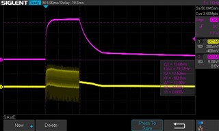

    Here are the 30% *C1 or 25.3nF on COMM1 and COMM2.  The OUT comes up to 5.4V.  tried raising the device off the pad to see if I can get it to lock.  Maybe the H field is too strong now and it is shutting off.  Not sure.
    In this case the waveform looked different, and OUT came up, where in the other cases, it didn't.

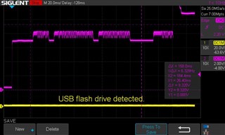

    It'd be best to measure with the housing/enclosure. It looks like the device is best working in that second image where you say it was difficult to measure. What is the meaning of the USB flash drive detected? Is this an oscilloscope feature or what occurs in your application?
    Would you also be able to show a wider scope shot of this? It looks like the RX is still communicating and it takes a few ms before the output fully comes on.
    Yes, you can find Figures 35 to show the operation with no load.

    I will go back to the COMM1, and COMM2 at 20% of C1.  I will measure Ls' in the stack shown below for my case not on top of the charging PAD.  I have done that way too, but I will do it again.  The calculations are posted in the first message for reference.
    Below is a cross section of the stack.  I also have ferrite material sheet I can add between the coil and battery for a second test to see if that would help.

    I tried again, added between the coil and the battery 38M3010AA1212 (1934-1086-ND Digikey) ferrite sheet the size of the battery. Peeled off the adhesive, and attached to the battery surface.
    Measured the Ls' once more and the calculations are attached below.
    C1 worked out to be 94nF, and C2 940pF with Ferrite in between coil and battery.  The measurements are shown below.
    I didn't change COMM1, COMM2 left it the same as 22nF.  I only updated the C1, C2 components and this time I see the CHG status LED ON and provides 5V output as expected.
    This was very difficult to figure out.  I had a hunch that more ferrite was needed to isolate the battery and board from the coil given they are in close proximity of one another.   Hopefully others can benefit from this extensive troubleshooting, ultimately resulting in success.
