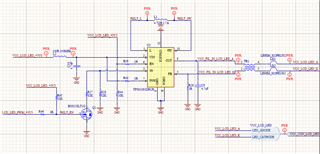

My schematic is below :

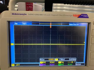

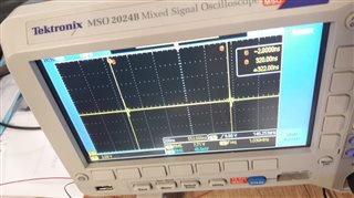

The main problem is that, when I powered my circuit, boost converter didn't give any output only 0V. When I touch the inductor pads, there is no any switching waveform.
I have detailed my circuit with oscilloscope against voltage spike or etc. on the input pins on TPS61081 but voltage ramps are good.
As an extra information, this circuit is produce +8V3 for LCD backlight for one time an then the circuit didn't work again. (I can not understand.)
When I supply the LCD Anode Cathode pins with external supply as +9V0, LCD is working properly and I can even see some characters at the screen like it must be.

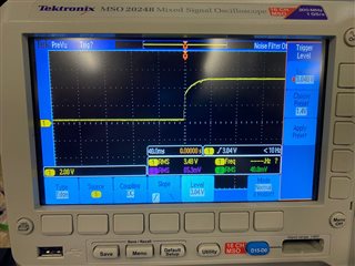

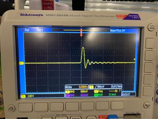

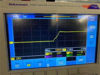

You can find my oscilloscope outputs for ENable signal, +5V0 VIN,  +3V3 supply for LCD (the same as ENABLE signal.), ENABLE signal
BOOST ENABLE signal +3V3 High                                            +5V0 VIN Input voltage ramp                                              +3V3 LCD powre supply ramp
Can the boost converter make protection against the effects that I didn't know it's cause ? The boost converter didn't give any response.  I tried different resistor configurations but these trials didn't affect the result.
  • I'm sorry for the picture, I messed up them.
    +3V3 Enable signal
    +5v0 VIN ramp.
    +3V3 LCD Supply
    The waveforms like burst signals are PWM signals and zoomed version at my first post.

    I notice you mentioned the converter is produce +8V3 for LCD backlight for one time an then the circuit didn't work again, since it is current mode, is it possible LCD voltage goes higher and triggers protection?
    1.Could you please measure voltage of IC Vin pin (after input filter) to confirm it not triggers UVLO. When output voltage goes higher, input current increases, voltage drop through source impedance and input filter also increase.
    2.Could you please measure voltage of FB pin and Vout pin (before output filter) when setting LED_PWM constantly high or low? We can confirm output filter does not affect it.
    Or can temporarily remove L2, TR1, LK1 to test board, other parts circuit seems designed okay and should work.

    I realized at my second trials that when I change the TPS61081 IC with new one. The new one can produce +7.3 /8.3 V etc. When I saw this output LCD backlight didn't work properly. I didn't see any character on the screen.

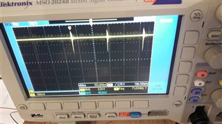

    After short time the output goes 0V again. As if LCD damages the IC. Another ineteresting issue is when TPS generate voltage and supply backlight current. Some noise occurs on the ENABLE +3V3 signals and +5V0 VIN power line. This noise affect +3V3 ENABLE signal voltage, noise decrease this voltage level to +1V6 etc.
    When I measure noise peaks (noise is affect the +3V3 and +5V0 lines like damped sinusoidal waveform.) I saw that between 2 noise waveform is 780ns. That means 1.2MHz. Disappointed

  • Hi Ugur,
    This big noise which affects EN and Vin may trigger UVLO and disable or even damage IC if leading to large current. 1.2MHz is just equal to switching frequency, it's interesting how it couples to these two pins.

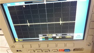

    #2 As second, When IC boost +5V0 input to +7.8V output, there is some anormal waveforms at +3V3 pull up line for enable pin and +5V0 main VIN pin. You can see from the pictures these power lines.
    +5V0 VIN
    +5V0 VIN
    +3V3 ENABLE
    +3V3 ENABLE
    #3 When IC generate this +7V7 after short time the output gose to +1.5V-2V0 and then this output voltage didn't change anymore.(IC is damaged. I think.)
  • Hi Ugur,
    #1 Whether the output is still 1.5V, after LCD is disconnected? And you can test input/output resistor to conform whether IC is damaged. If damaged, I notice when powering 420mA, LCD can work, maybe large load current damaged the chip and you can try to change R27/28 or R26 working at 420mA like I suggested before.
    #2 From the waveforms of 5V0 VIN, I think the voltage is about 8V, is it the output voltage? What is Vin at this point? You can check VCC_LCD_LED3V3 because EN signal is input signal.
