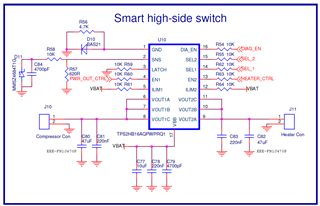

We are using TPS2HB16AQPWPRQ1 for a project. We are facing a problem. We are seeing 60-70% of failures in our devices. TPS2HB16A does not give output on both channels despite being enabled. Sharing the schematics used in our board. The enable signals are controlled by a controller with 3V3 logic high levels. We are following all the guidelines mentioned in the datasheet but we are still facing issue with the output. We checked soldering connectivity as well. There is no difference in the functional vs non-functional board except that the IC is not giving output. This is a showstopper for us. Hoping to find some solution as quickly as possible to resolve this. As part of debug, we checked the SNS pin voltage levels hoping to find some fault. Here are the observations we made:

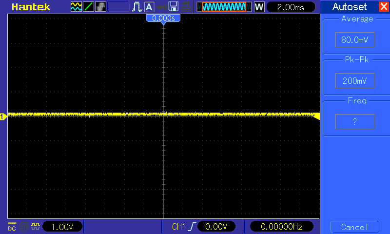

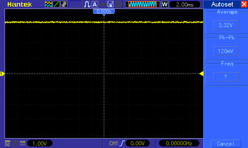

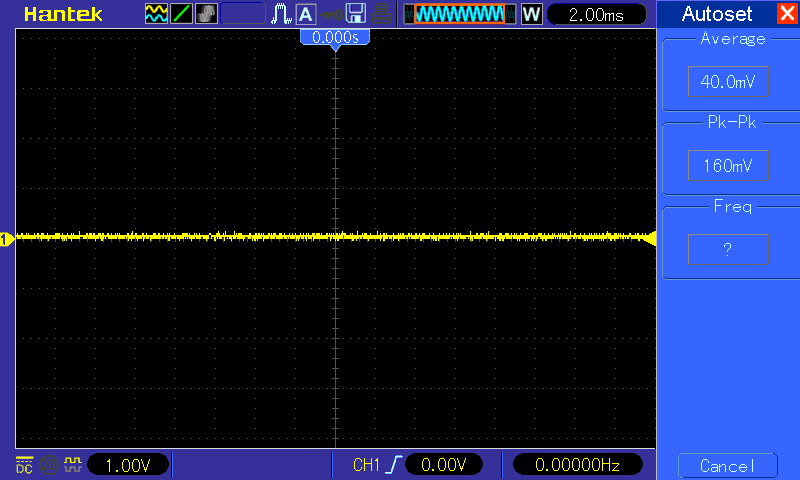

    2. For the non-functioning board, could you collect waveform at VBB pin, EN1 pin, VOUT1 and VOUT2 pin?
    >> Attached waveforms. The voltages were
    VBB - 11.1V (w.r.t. digital ground), 10.57V (w.r.t. IC ground)
    EN1 - 3.26V (w.r.t digital ground), 2.63V (w.r.t. IC ground)
    VOUT1 - 0V (w.r.t digital ground)
    VOUT2 - 0V (w.r.t digital ground)
    3. By no load, you mean put the load to open correct? It's a little puzzling to me that for the functioning board, it should detect the open load condition and pull the SNS pin high, but it stays at 0V.
    >> Yes, the load is open and EN1, EN2 pins are high. SNS shows 0V.

  • Hi Viraaj,
    It looks like the device has no fault, and it's not enabled. Since there's a ground protection diode, that introduces ~0.7V voltage drop, which causes the control signal seen by the IC to be lower (verified by your measurement). Although it's still above the 2V threshold, and theoretically it should be turned on, could you try to give EN pin a 4-4.5V voltage with respect to the digital ground and see if the FET is able to turn on?
