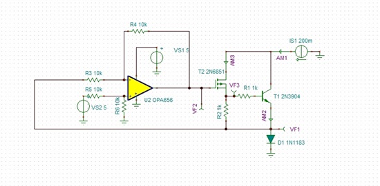

  • I have modified it a little bit. the parameters are not exactly the same as I need.
  • David,
    I think you make need to check that circuit, there doesn't appear to be any feedback path from the output voltage or current.
    Also, we need to understand if you need a Current regulator or Voltage Regulator.  Your earlier message seemed to indicate that you needed a voltage regulator.
    The above circuit's op-amp is driving VF1 (voltage drop across D1) to be equal to VS2 (which looks like 5V) but with a limited gain stage  (R4 / R3 = 1)
    Have you simulated this circuit with a resistive source at the ouptut voltage - say a 10ohm pull-up to 22V (which should draw 2A if the ouptut voltage is driven to 2V) ?
  • So sorry for the unclear information I provided to you.
    Yes, I only need a voltage regulator with +2V output.
    I configured that op amp as difference amplifier, the function of this op amp is to fine tune the P mosfet to let it turn on further or lower based on the forward voltage of diode( this diode can carry 200mA with 700mV, I don't have diode model which can carry 2A at 2.1V forward voltage).
    Yes, you are right that reference voltage should be 700mV.
    Based on my previous experience with TINA the difference amplifier can’t work properly and I have asked technical support from TI regarding to difference amplifier, they can’t figure it out.
    I have simulated this circuit without that op amp; the rest of circuit can work.
    I have modified the configuration as attached :
    Sincere thanks for your generous answers.
  • Let's look at the FET.  The source is connected to the base of T1, whos emitter is at VF1, which presumably we want at 0.7V, so we'll estimate the base voltage is about 1.4V.  This would cause the Gate-Source voltage of T2 to be - 1.4V.
    If the diode voltage (Vf) is low, (0.6V) the Op-Amp's ouptut increases (0.1) increasing the Gate-Source voltage on the P-channel MOSFET (less negative), reducing the current into the BJT's base, decreasing current, decreasing Vf.  This increases the ouptut voltage, further decreasing the Gate-source voltage on the P-channel MOSFET until Vf = 0, the gate of the P-channel FET is +0.7V, holding the MOSFET in the OFF state.
    I don't think this circuit will work to regulate a 2V output voltage.
