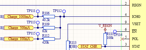

Hi all
My customer has a design with the BQ25302 and has three current limits selectable by the uC I/Os (schematic below).
100mA / 500mA / 1A
What happens in a low battery situation when the uC is not running ?
Consulting the datasheet I assume the BQ25302 will not charge / switch.
How should one handle this situation ?
.... just have the R112 (420k) connected to GND so that by default the BQ25302 will start with 100mA ?
The customer has a second question for page 9 of the datasheet:
RICHG_HIGH ICHG setting resistor threshold to clamp precharge and termination current to 63mA RICHG > RICHG_HIGH 60.0 65.0 70.0 kΩ
He is not sure what this means, can you elaborate ?
