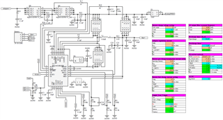

And here is my schematic as well as screenshots of the design calculations, from the tool provided by TI:
The test was conducted using a laboratory power supply, set at 24V and 6 A, as the power source. All the FETs that control the power switchover are working and the battery does start to charge when the power supply input is applied. the charge current is just too low.
I tested two different batteries, one from low state of charge and from from a medium state of charge, with the same results. I charged both batteries with the lower charge current of 1.35 A until the charger stopped charging. This stop occurred at 12.45 V, rather than 12.6 V as per the design. The controller is supposed to end with a constant voltage phase and then terminate with a low current (0.45 A as per design), yet I did not observe a constant voltage phase and charging was terminated with 1.35A still flowing.

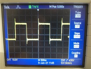

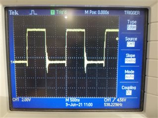

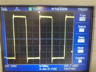

      It looks possible that the ground routing for your board is not ideal. This is why it is sensitive to your multimeter, as well as the shift in expected ISET1, ISET2 versus measured values. Can you take a waveform of SRN, PH, HIDRV and LODRV when the part is switching in CC mode? Do you have any other circutry hanging between the battery and SRN? Also are you using your real battery for the output when testing your board?
  • Hi Kedar, thanks for your reply.

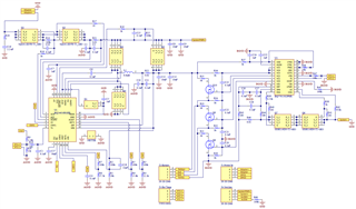

    Below are the waveforms you requested. If I understand you correctly, there is no other circuitry between the battery and SRN. There is however also a battery protection and cell balancing circuit. This circuitry can disconnect the negative of the pattery from the ground with some FETS. I have also included a schematic that also shows this part bellow. If you are convinced it is a problem with the ground, could you please offer some guidelines for possible fixes?
    HIDRV:
    LODRV:
    PH:
    SRN:
    Updated Schematic with battery protection part:
