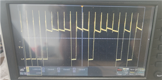

I got a not stable output with following schematics:
The output seems oscilating all the time. I will attach waveform later.
BP has got stable 5V. What's the EN timing?  I saw EN is always low, but the output begin to oscilate.
Peter
  • Hi Peter,
    Please do share the waveforms if possible. I took a look at your design and everything seems fine from the first pass analysis, but looking at the waveform may help further explain.
    If EN is low, the power stage of the TPS543C20A will be disabled. Is it possible that the noise you are seeing is coming from another part of the system?
    Please see section 8.4.3. of the datasheet regarding the timing and behavior of EN.

  • Hi Alec,
    The following is output waveform. Sorry for wrong information, EN is about 2V, not low.
    I have disconnected most of the load,
    Peter

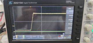

  • Hi Alec,
    This is start up waveform.
    Peter
  • Hi Peter,
    If EN is left floating, it will be pulled up to BP internally. The waveforms you showed look like the device is current limiting. Based on your Ilim resistor selection, the current limit should be around 34A. Would you be able to capture the SW node by chance during the startup event? Also, I know you mentioned most of the load was removed, but is there any low impedance path to ground the output sees?

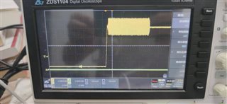

  • Hi Alec,
    The following is output and BST(green) waveform. I measured the output impedance (not powered up), and it's more than 10K. Short to GND shouldn't be the cause. But if you think it's overcurrent, I will check other non-passive components.
    There are only a few supporting components for this chip. I don't know which one i should change for debug.  Is Rramp worth trying from 187K to 51.1K for control loop? or trying connect a electrolytic cap?

  • Peter,
    I think a few things may be worth looking at in this scenario. I would first examine if a lower ramp setting helps correct the issue (51.1 kohm and 8.66kohm are two options you could look at given the large inductance). I would also try a lower inductor value as our design tools recommend 0.500uH- 1.5uH for this application. Changing the inductor value will likely create a need to change RAMP. Please let me know if this is a feasible option and I can recommend a RAMP value based on the inductor selection.
    A final debug option, that I do not suspect is the issue but is nonetheless something to rule out is pulling out the LED pulled down by PG. This provides a load on BP, which should be sustainable given the rating of the part, but I would like to rule it out as an issue if the RAMP and inductor changes do not succeed in your case.
    Alec Biesterfeld
