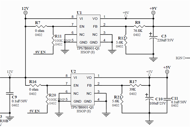

Hi Team,
There is a good new that DIN LMR33620
Please help check this SCH, THX
Hi Team,
If possible, please consider adding a small 0.1uF or larger input cap right at the input pin of the LDO as a good design practice. In addition, please make sure the 220uF C3 is meeting the ESR requirement listed in the datasheet.
