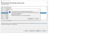

When we use BQ40Z50 and BQStudio, the following content is suggested. May I ask if there is any bad effect? Now we cannot connect the board through EV2400.
  • When bqStudio execute, it will try to read device ID and firmware version to open bqz.file respective. If the process is failed, the target selection wizard will be show up to user to select. If selected firmware version is not the same with connected one, the memory address could be mismatch to cause wrong memory information show up. Meanwhile, any memory modification is possible to write wrong address to cause unpredict result.
